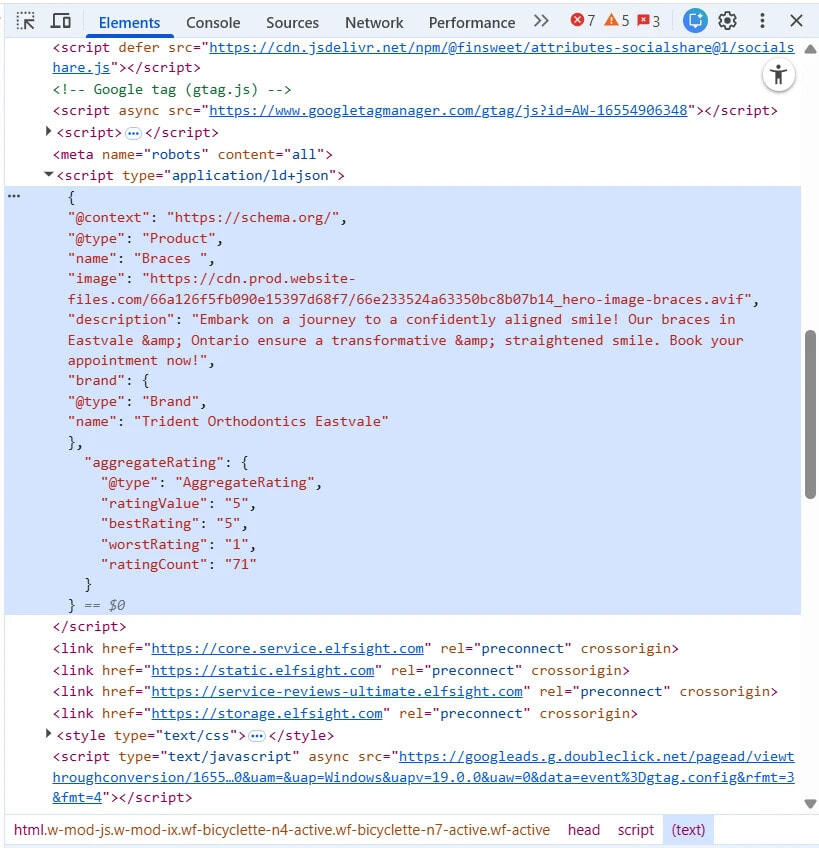

Hi Thank you for your help. I moved the code and it seems to be working now but for some reason the review count is stuck at 71 but we’re at 252 on google review

This screenshot shows the markup from your website’s <head>, but it doesn’t show the widget markup:

Yes I can see that from my end. I did notice this. Does it matter that this one is only 71 and the other one is 254?
In your screenshot there is a markup that you’ve added to your website’s <head> and it’s not related to our Google Reviews widget:
The markup of the Google Reviews widget is working fine and shows the correct number of reviiews (254).
