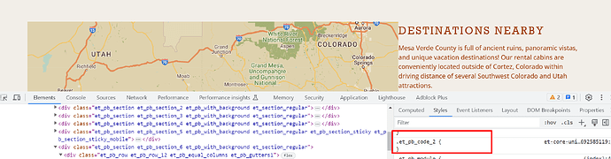

I see there is a code in Divi (not sure this is Divi code, or code you added)?
I tried remove it from my browser & map fine here

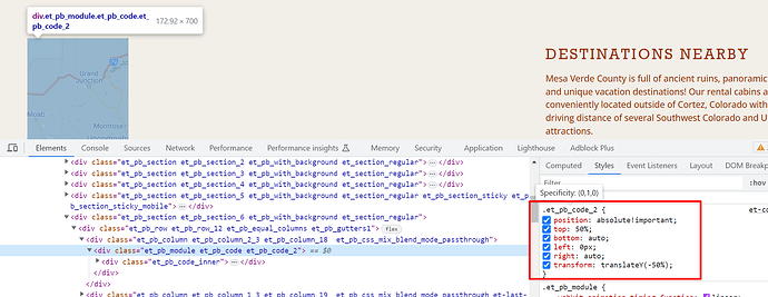

Sure enough, the absolute positioning was from a previous map I was experimenting with prior to Elfsight, oversight on my part. Appreciate the help.
