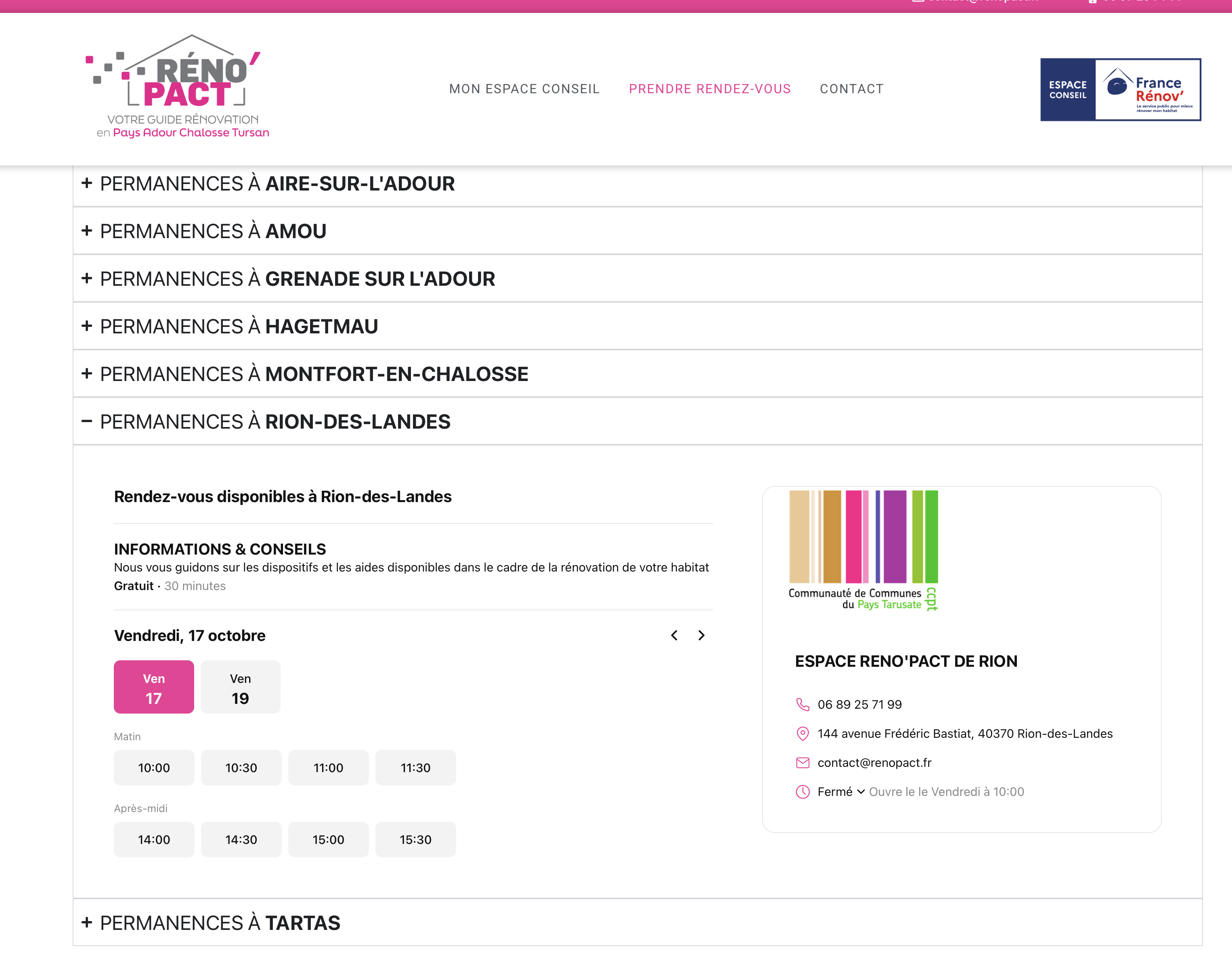

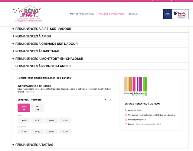

Here’s a screenshot I just took from the website (I cleared the cache and reloaded the page). The 10 a.m. time slot is still available.
Indeed, when you select it, it disappears for a minute or more. Then, suddenly, it reappears. Also, as you recommended, I linked the calendars to a Google Calendar account, but the appointments don’t appear on Google Calendar.

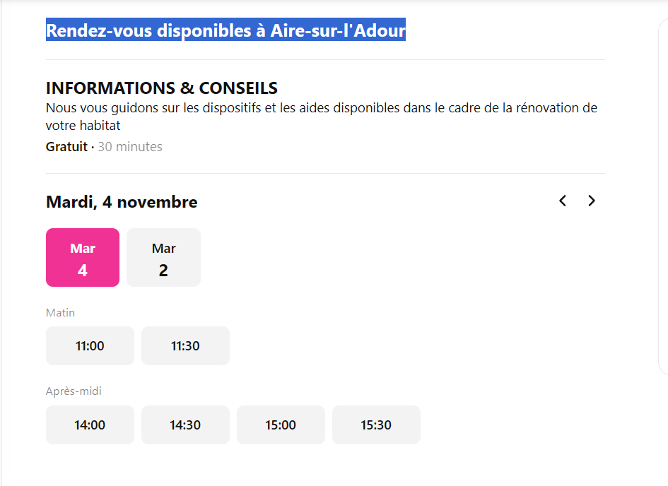

Yesterday I’ve tested a calendar Rendez-vous disponibles à Aire-sur-l’Adour and reserved a 10:00 slot. I’ve checked your website again and this slot doesn’t show up on my end:
In your screenshot you’ve shown a Rendez-vous disponibles à Rion-des-Landes, which is a different widget and has a separate schedule. The reserved slots don’t get blocked there, since you’ve added 2 emails to the Owner Email field:
Since only 1 recipient can be added to the widget, please remove 1 email and you should be fine.

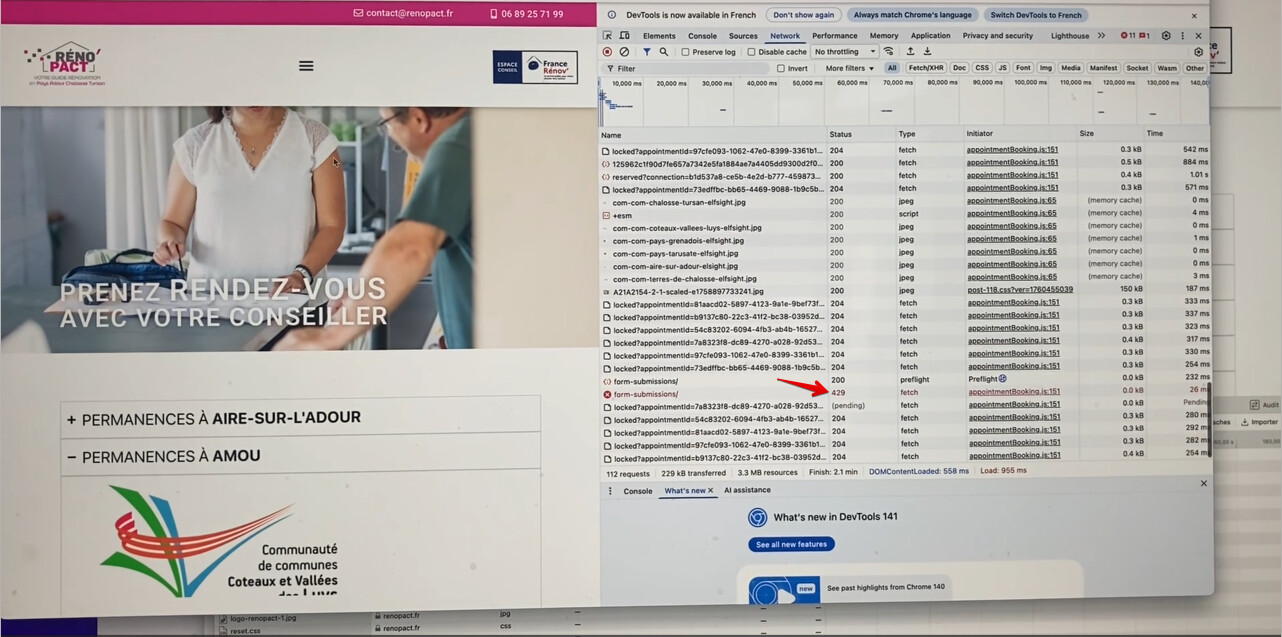

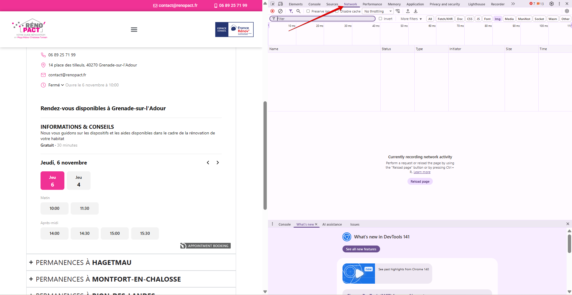

To understand what caused the slot blocking issue on your need, please send us a video screencast of the booking slot process with the open Network tab. To open the Network tab, please right-click your website, choose “Inspect” and then “Network”:

I’d love to help you sort this issue out to your satisfaction. To troubleshoot the issue, could you please take this step?
  • If the reserved slot is still showing on the schedule, please check your website in your browser’s incognito mode and let me know if it appears there.
I understand there are some challenges with recording the screencast, but is there a chance you could use your smartphone to capture a screen recording of your desktop with the open Network tab? This might help us identify the cause of the issue :folded_hands:

Yep, thank you so much - that’s really helpful!
I’ve forwarded your recording to the devs and will get back to you as soon as I have any news.

Our devs have investigated the issue and here’s what’s been found.
In the screencast you provided, we spotted a 429 error. This error occurs when too many requests to submit a form are sent from the same IP address in a short amount of time. So, this is a reason, that caused the issue with blocking the reserved slots on your end:

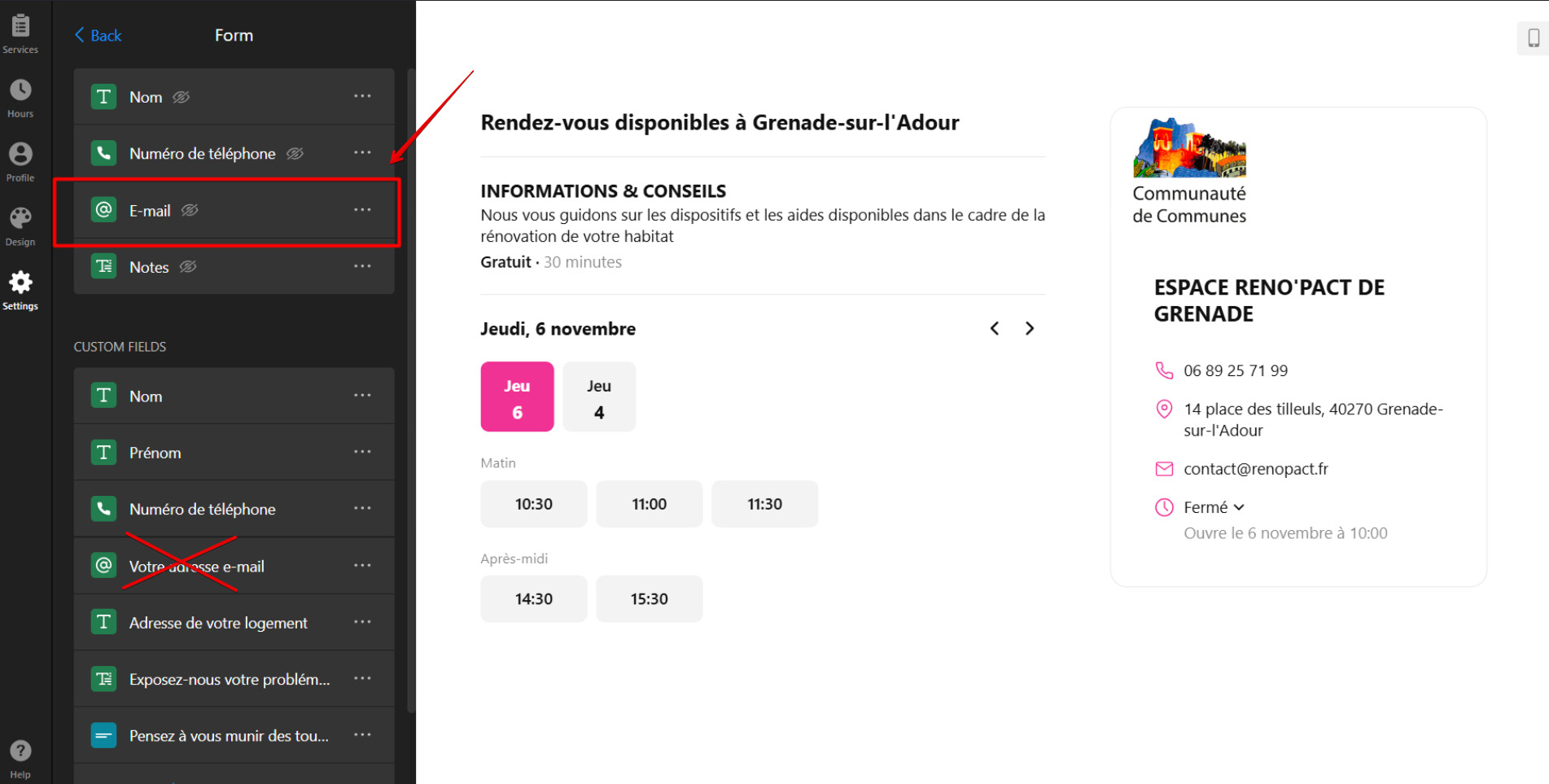

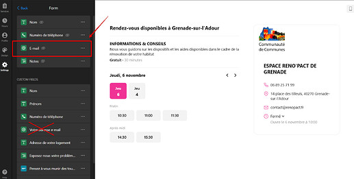

As for the client confirmation email, the thing is that you’ve added the Email field as a Custom field. This means the email address entered there isn’t recognized as the one to send notifications to. To fix this, just add the Email field as a default field (currently, it’s hidden in your widget):
Please let me know if this clarifies things or if you have any questions left :slightly_smiling_face:
