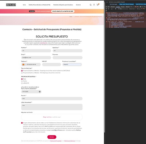

  • Issue description: Submit button not works, its in the console, the problem is recursive in web but if create a new form builder ans test it, not work, submit not work, is a critic general error !!!
  • Link to the page with the widget in question: is in console the problem, and recursive in web

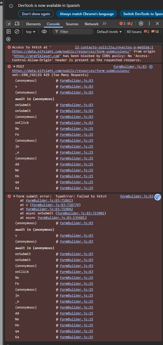

And the problem is in the elfsight consolé and recursiva in web, i test in consolé and sometimes can send and much others not, in the vídeo that send you in the last message can see that submit button not work properly , when i clic in submit must be appear a thanks message but not send and not put the message, its how refresh or if will be blocked
I see the problem is when i active my internet provider… i put off our internet and the forms works ??? With other provider??? What is this??? Whats happened??? Can help us because its blocked with “””our””” internet….. not understand, never pass this , reset our internet but nothing…. If try in mobile without our wifi, works..: really not understand

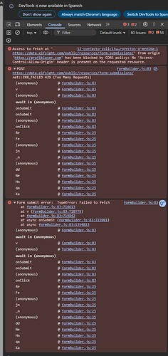

Hi Max, the problem persist, i see in the inspection that the error is that elfsight is blocking my public ip, maybe because im testing and i need verify if the message go to my email and ticket system how always… there is an option for that elfsight not blocked me?? the problem is too many request…. we have 7 forms builders and others submit forms and really wil be happy if elfsight not blocked to me that i pay my suscription and understand that i can test,… no??? if i will be blocked for test three sends im not happy… please can help me ? thanks

I totally understand the frustration. It looks like you’re hitting the error 429 because too many requests from the Form are being sent in a short period of time. We have limits in place to prevent spam attacks:
  • No more than 5 submissions/minute from a single IP address
  • No more than 60 submissions/hour for each widget
Unfortunately, these limits can’t be turned off, but they are there to ensure fair use and prevent spam attacks on our servers.
I totally get that you need to test, though. I recommend spacing out the form submissions a bit to avoid hitting the limit :folded_hands:
