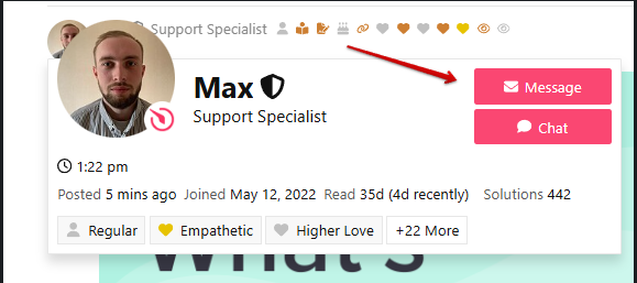

Could you please specify the format of the images you are using? Also, it would be tremendously helpful if you could share a link to one of the images :pray:
You can send me the link in private messages:
Hi @Max , the images are just JPGs, nothing weird… So not sure that would be a problem. Sending an image in messages now.
