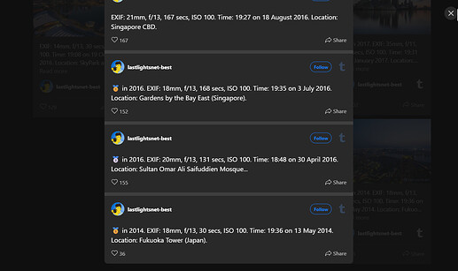

Our devs investigated this behavior and here is what’s been found. If the images haven’t yet been cached by the browser, and we click on one of the latest posts, the popup opens like this:
When clicking on the last post, the page scrolls to it, but the post still appears at the bottom of the screen because of the popup positioning. Then, once the images load, it shifts downward below the viewport.
