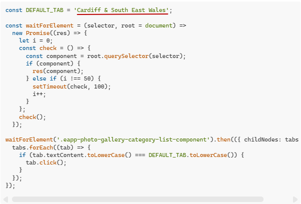

Here is a script from the devs:
const DEFAULT_TAB = 'Cardiff & South East Wales';
const waitForElement = (selector, root = document) =>
  new Promise((res) => {
    let i = 0;
    const check = () => {
      const component = root.querySelector(selector);
      if (component) {
        res(component);
      } else if (i !== 50) {
        setTimeout(check, 100);
        i++;
    check();
waitForElement('.eapp-photo-gallery-category-list-component').then(({ childNodes: tabs }) => {
  tabs.forEach((tab) => {
    if (tab.textContent.toLowerCase() === DEFAULT_TAB.toLowerCase()) {
      tab.click();
Set the name of the needed category in the 1st line of the code, and add the resulted code to the Custom JS field on the Style tab of your widget’s settings:
Test it out and let me know if it helped :slightly_smiling_face:

Thank you Max, that works really well as it does what I wanted and also improves load speed as not so many items are gathered. Thank you for the amazing service!
