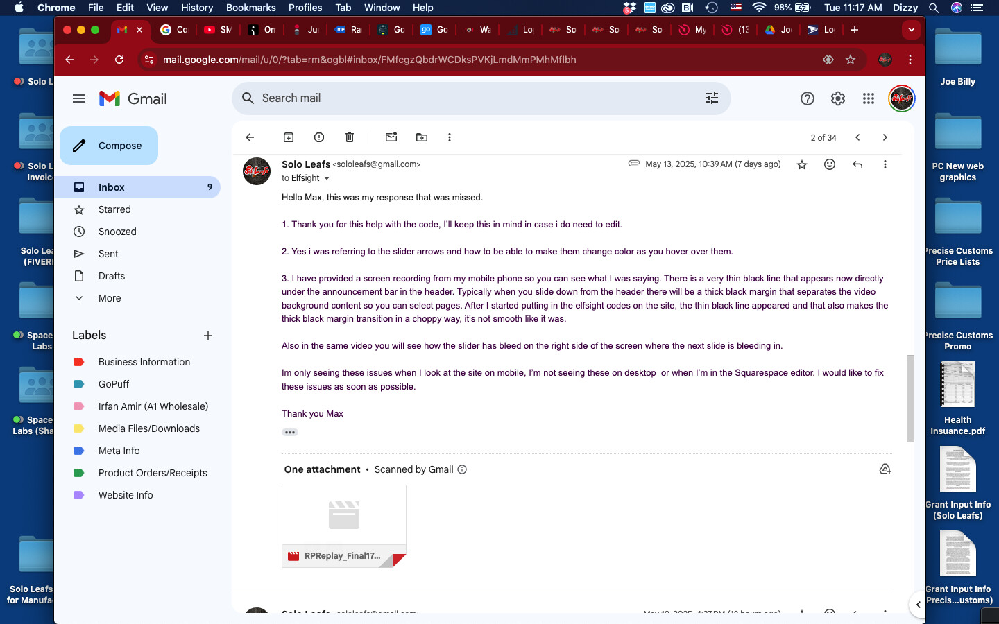

I am responding via email, I am attaching screenshots where I have provided the information and a visual you asked for.

Thanks for sharing screenshots!
Now, I see a thin black line. I’ve tried to temporarily disable all our widgets on your website, and this black is still displayed. This means that not our widgets cause its appearance.
You can make sure of it using the Hide from the website feature:
As for the widget bleeding on the right side, unfortunately I couldn’t replicate this issue. Could you please attach a video screencast right in this thread on the Community. It seems that when you send emails with attached files, these messages aren’t delivered here for some reason.
Regarding the color changing of the navigation buttons, our devs will come up with a custom code for you. I’ll get back to you with a solution tomorrow.
